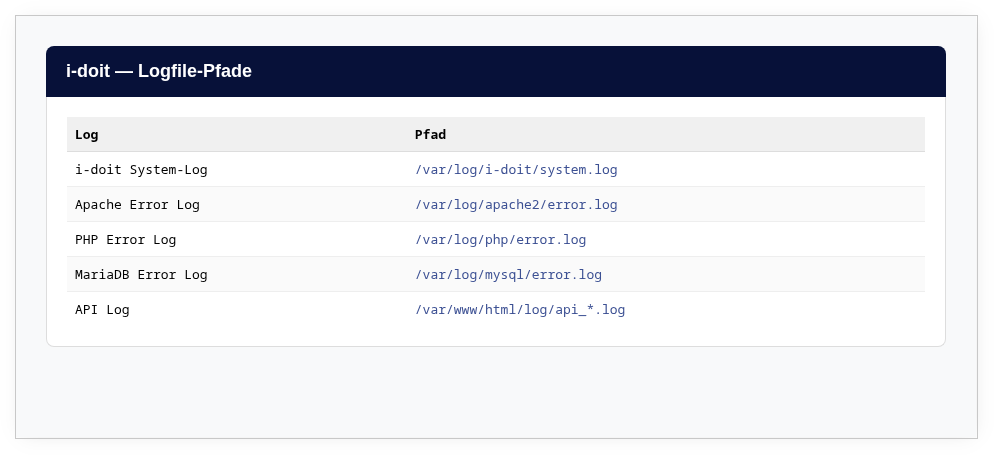

i-doit log files#
All i-doit-specific logs are located in the installation directory under log/. The most important files:
File Content
log/exception.log PHP exceptions — the most common starting point for error messages in the interface. Enable under Administration → [Tenant Name] Administration → Settings → Logging → Exception Log.
log/system.log General system messages from i-doit
log/ldap_debug.log LDAP connection and sync log (when ldap.debug is enabled)
log/import_*.log Import logs for CSV, JDisc, and other imports

PHP and web server error log#
Not every error is logged by i-doit itself. PHP errors and fatal crashes end up in the web server's error log:
  • Debian/Ubuntu (Apache): /var/log/apache2/error.log
  • RHEL/Rocky (Apache): /var/log/httpd/error_log
  • Nginx: /var/log/nginx/error.log
