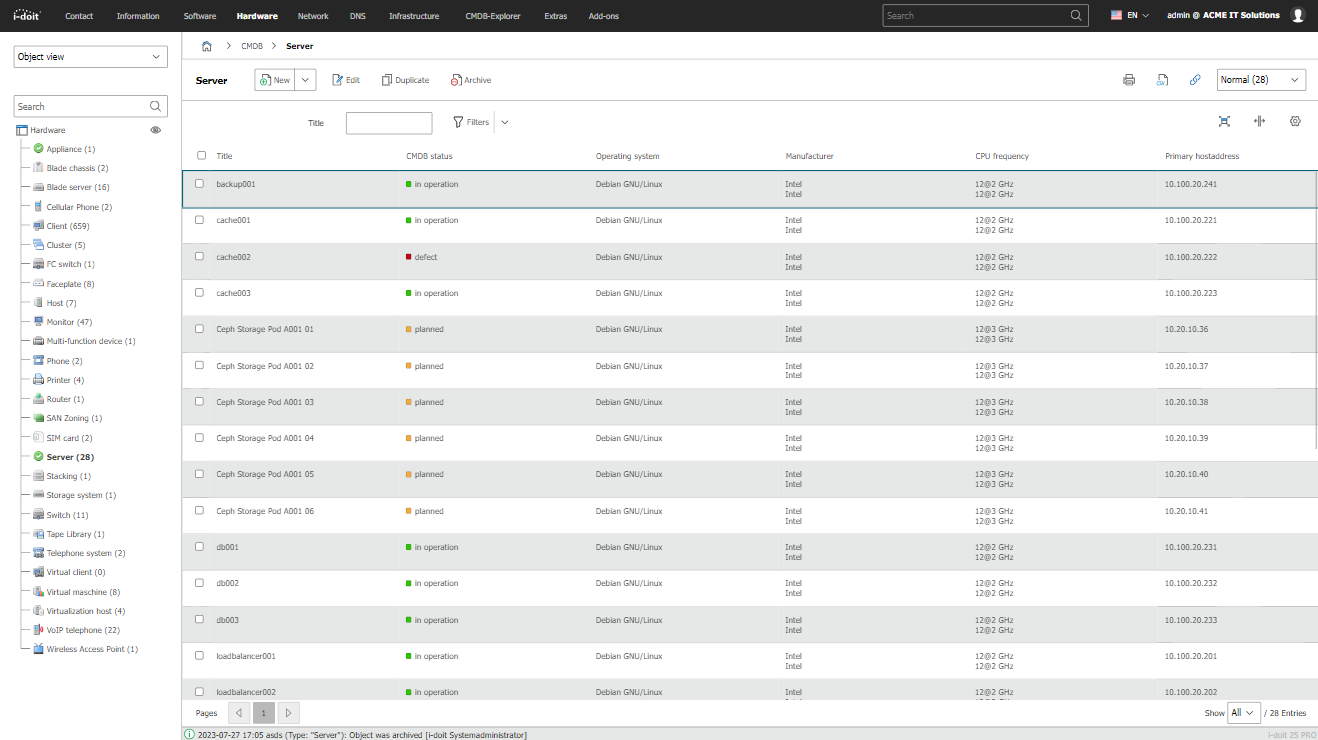

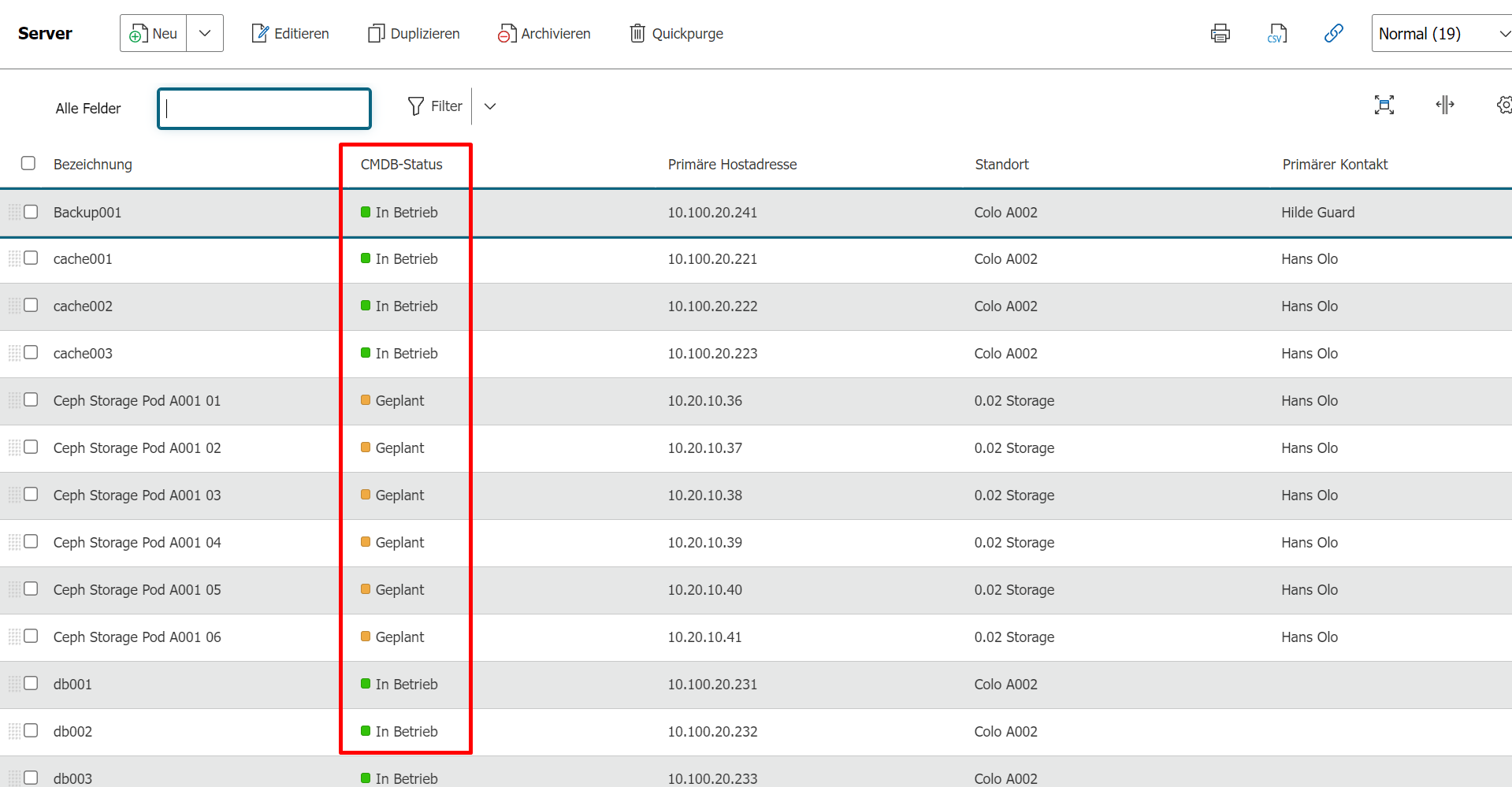

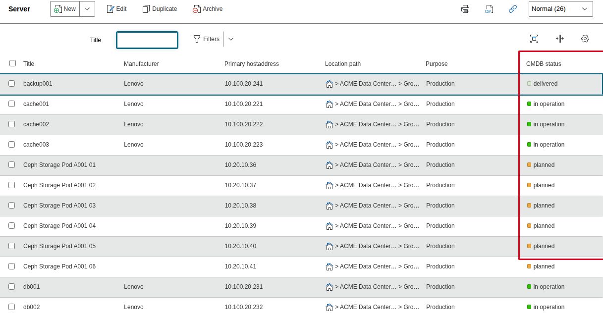

The CMDB status can be displayed as a column in the object lists to quickly look up the target state of a documented object.
cmdb-status

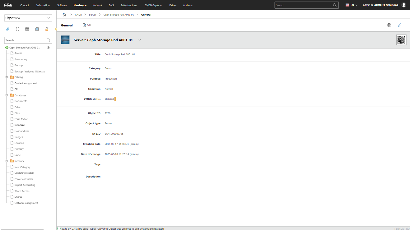

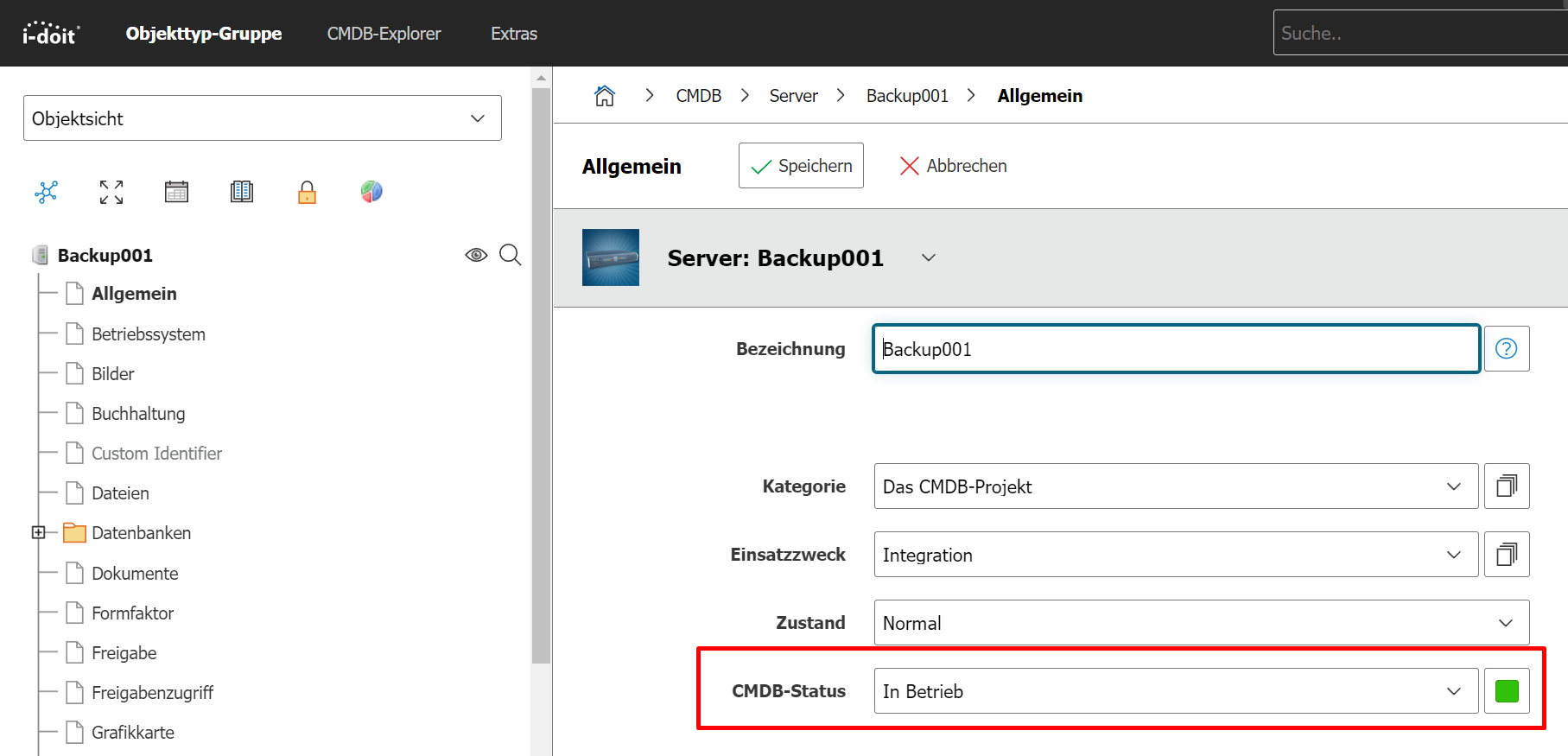

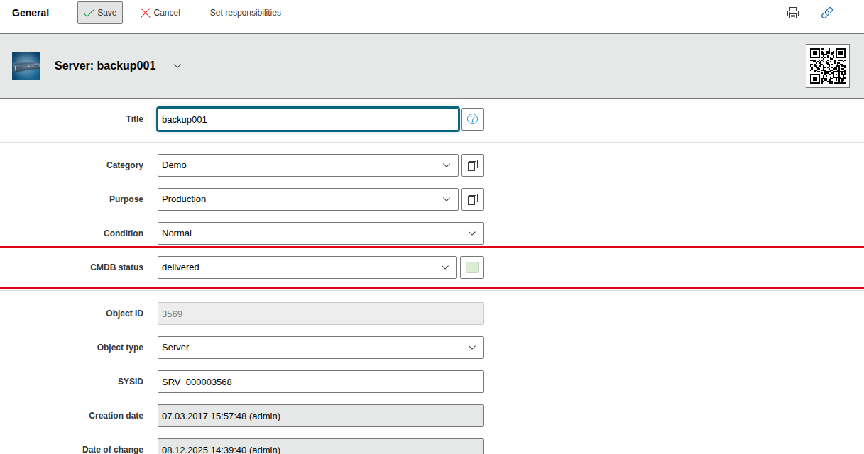

Specifying CMDB status per object#
To map the entire life cycle of an object, the attribute CMDB status in the category General is used per object. When a new object is created, it receives In operation as its CMDB status, unless something else is explicitly specified.
cmdb-status-per-object

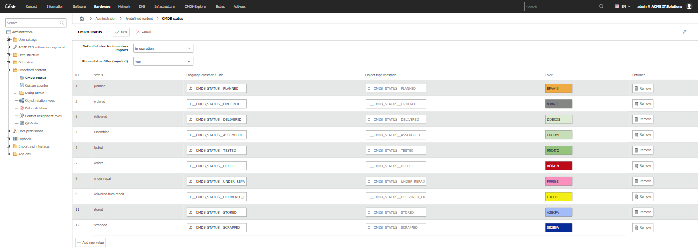

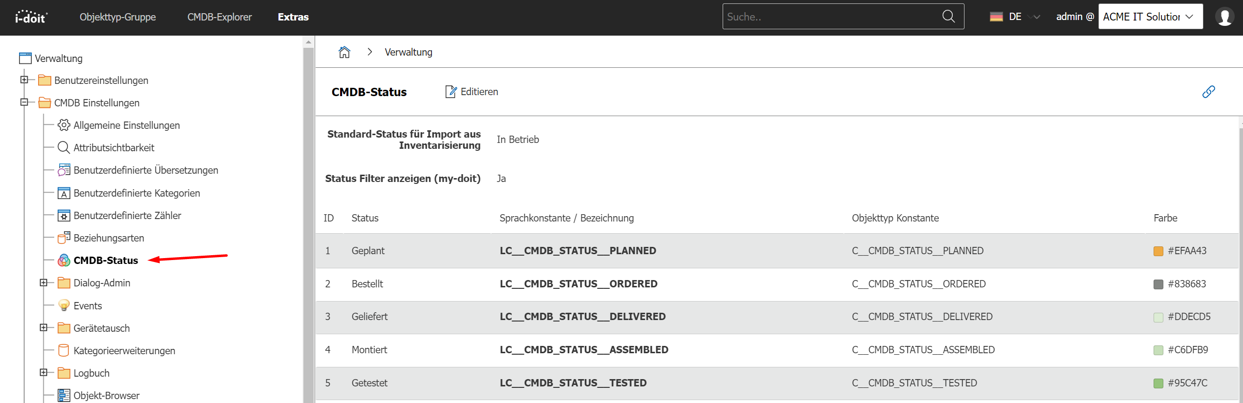

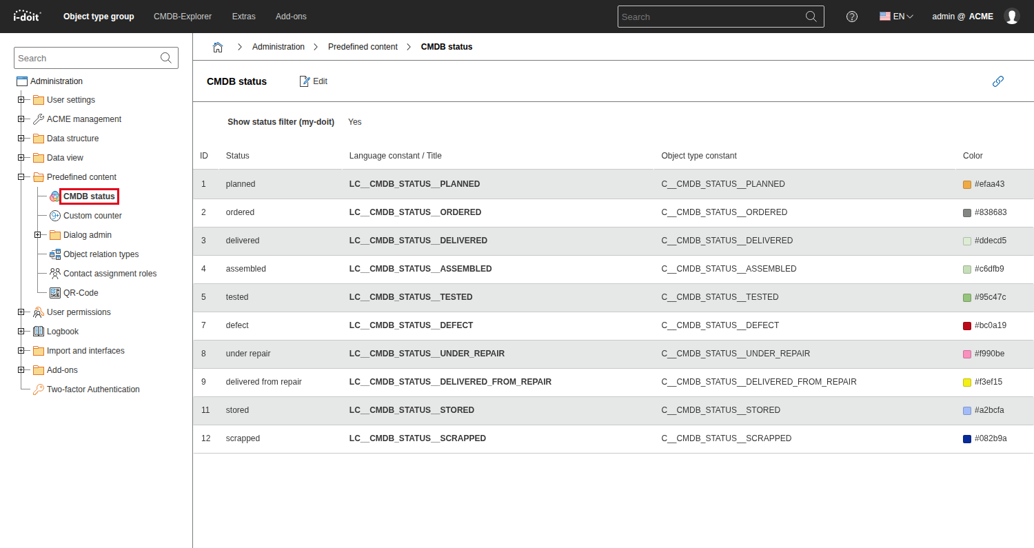

Managing CMDB status#
Adding, changing or deleting a CMDB status is done via Administration → Predefined content → CMDB status. The following information is required per CMDB status:
cmdb-status-manage

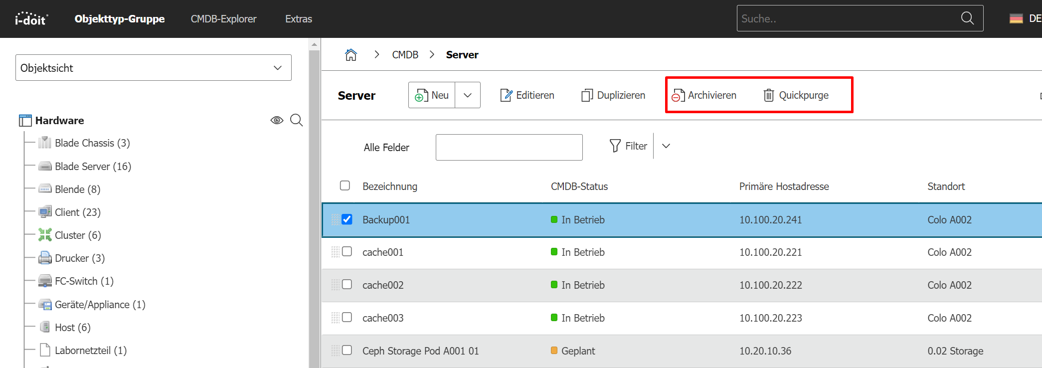

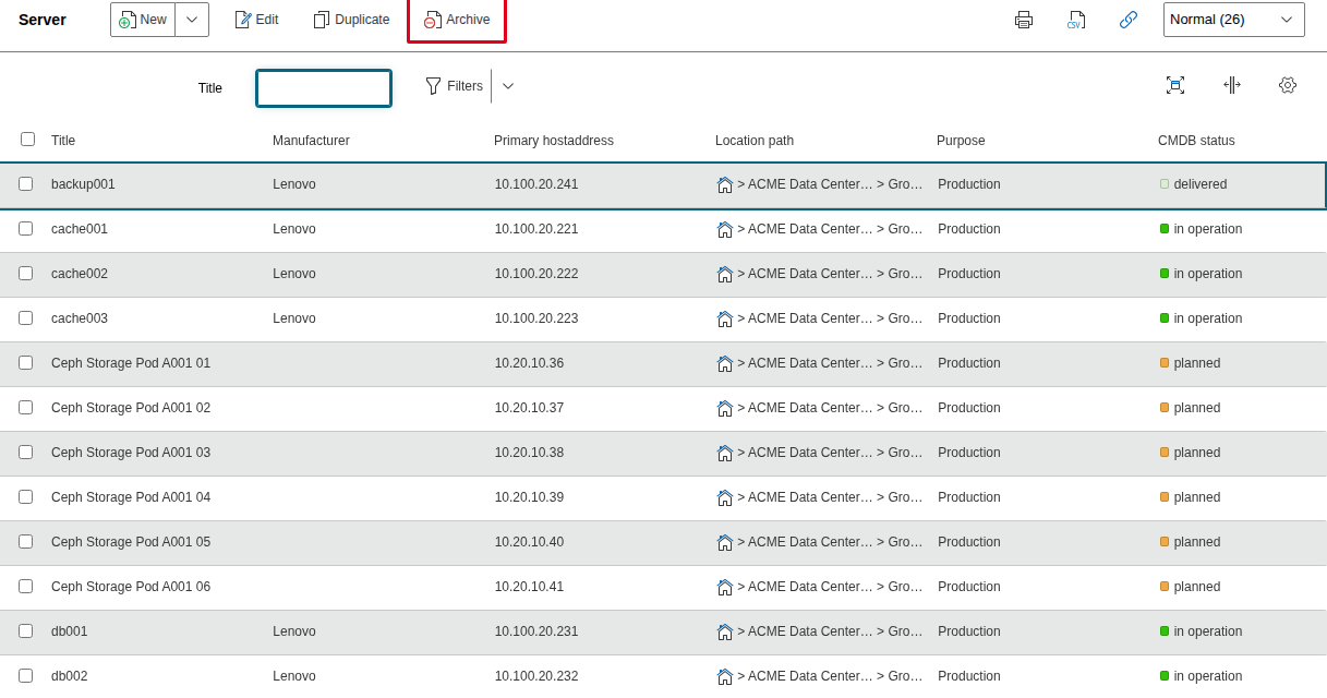

Archiving, marking as deleted or irrevocably deleting (purge) objects#
You can see the condition of an object in the General category. To change the condition of one or more objects:
  1. Open the object list.
  2. Check the checkboxes of the desired objects.
  3. Click Archive, Delete or Purge.
archive-or-purge-objects

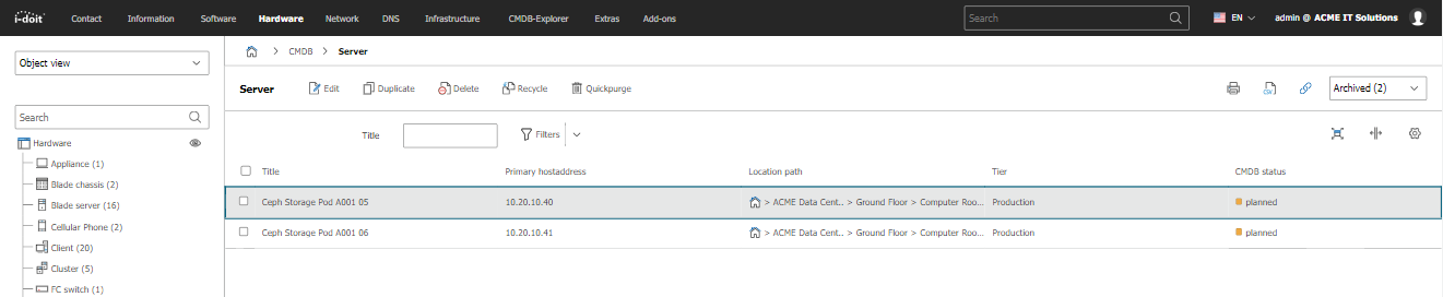

You can only change to the next possible condition. An object with the status Normal can only be archived from the list. To delete, filter for archived objects in the upper right corner and then change to the Deleted condition. With Restore you can return to the previous condition at any time.
When irrevocably deleting (Purge), there is no confirmation prompt -- unless relationships to other objects exist.
