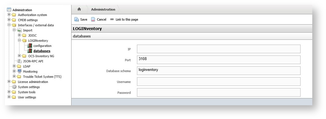

Settings in i-doit#
The settings for LOGINventory can be found at Administration → Interfaces → external data → Loginventory.
Configuration of the Database#
IP: server on which the database is located.
Port: the IP port for communication (default 3108).
Database / Schema: database description (default loginventory).
Username: user name for logging in to the database.
Password: self explanatory.
