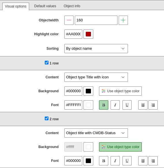

The graphical representation of the tiles is defined in the Visual options tab. The highlight color and the width are set there. The lines to be used are activated by ticking the checkboxes. Each object can have up to eight lines. The configuration is identical in each line. The content of the line is selected in the drop-down menu. Here some predefined attributes are available for selection. The background can either match the object color so that it is independent from the object type or you can use a custom-defined color. You can determine the font color as well as the character formatting. The formatting options are defined via the buttons.
Visual options

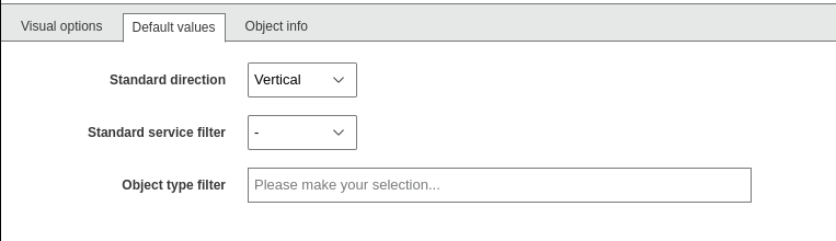

The Default values tab allows you to set values which can also be adjusted during application. Here you can set the direction and the standard service filter as well as define the object type filter. The object type filter limits the view to the selected object types.
Default values
