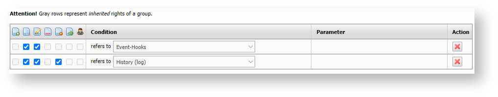

Assigning rights#
Under Administration → Permissions → Events, permissions for persons and person groups can be adjusted.
Assigning rights

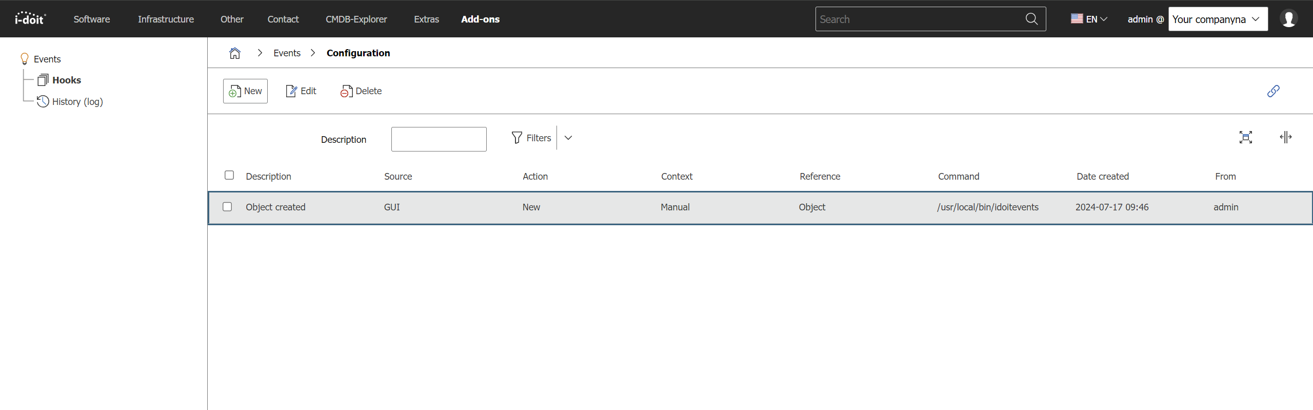

Configuration#

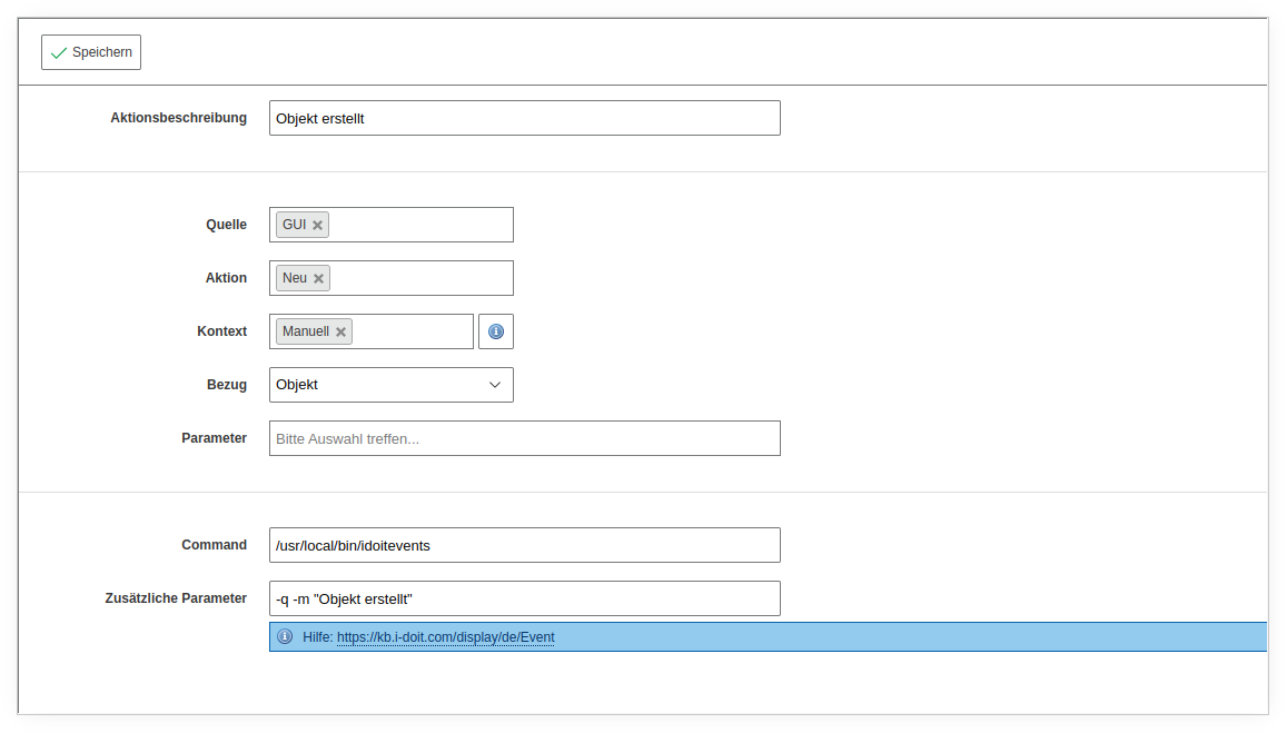

The configuration is accessed via Administration → Add-ons → Events → Hooks.
Configuration

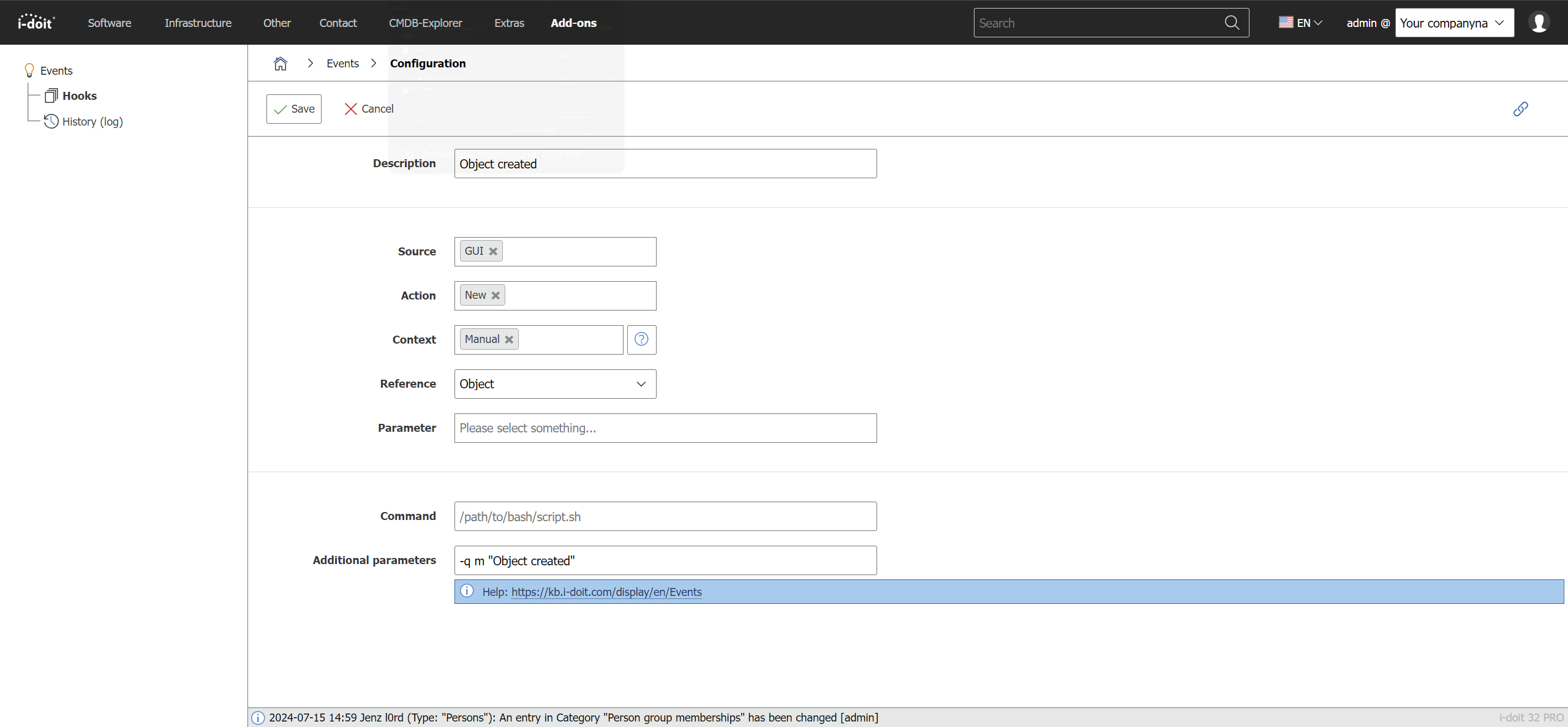

You combine events with command calls. An event is triggered by a hook -- i.e., during an internal routine in i-doit. The following events are available:
For all states in IT documentation, there are corresponding events. You can create any number of event-to-command-call combinations.
When a configured event occurs, i-doit immediately executes a shell script. Note the following:
  • The script must be executable by the user or group under which the web server runs (on Debian: www-data).
  • On GNU/Linux, set the execute permission bit (chmod +x).
  • Any programming language is supported, as long as the operating system supports it (Bash, PHP, Python, Perl, etc.).
Command call
The shell script receives information about the event as BASE64-encoded JSON. Here is an example after decoding -- it shows saving a category entry:

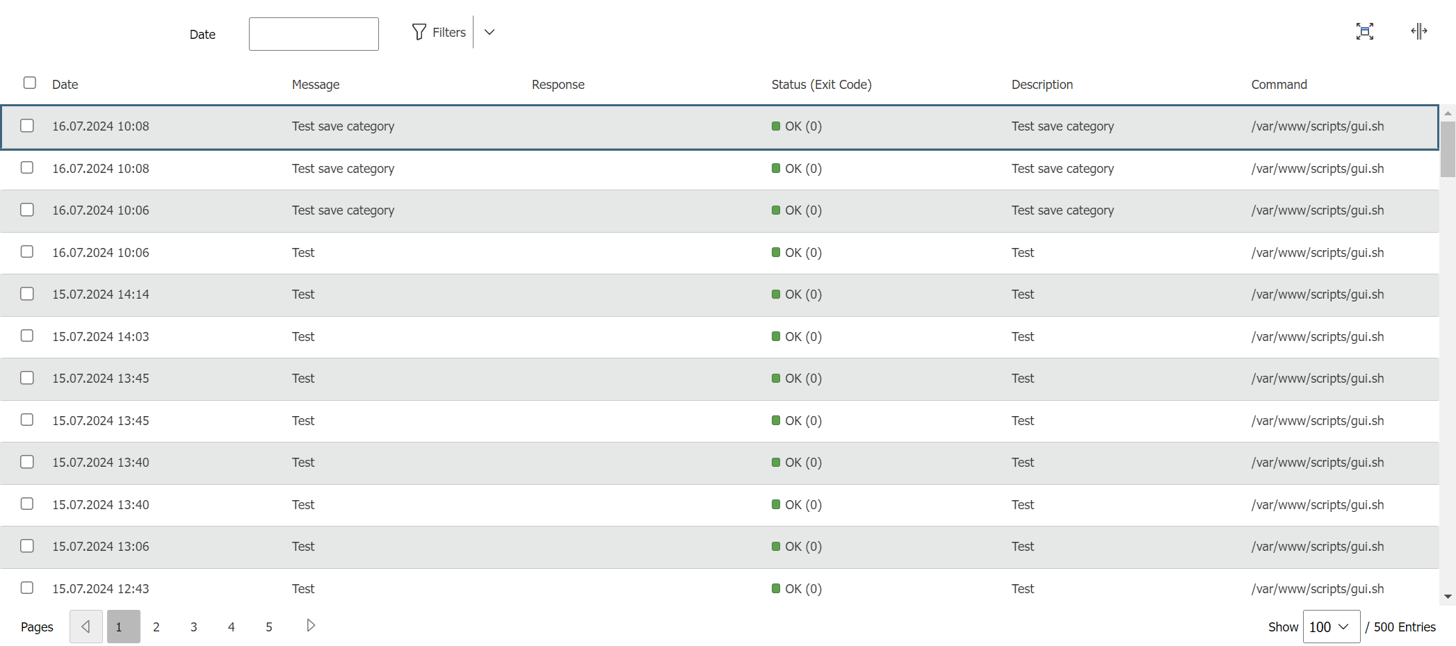

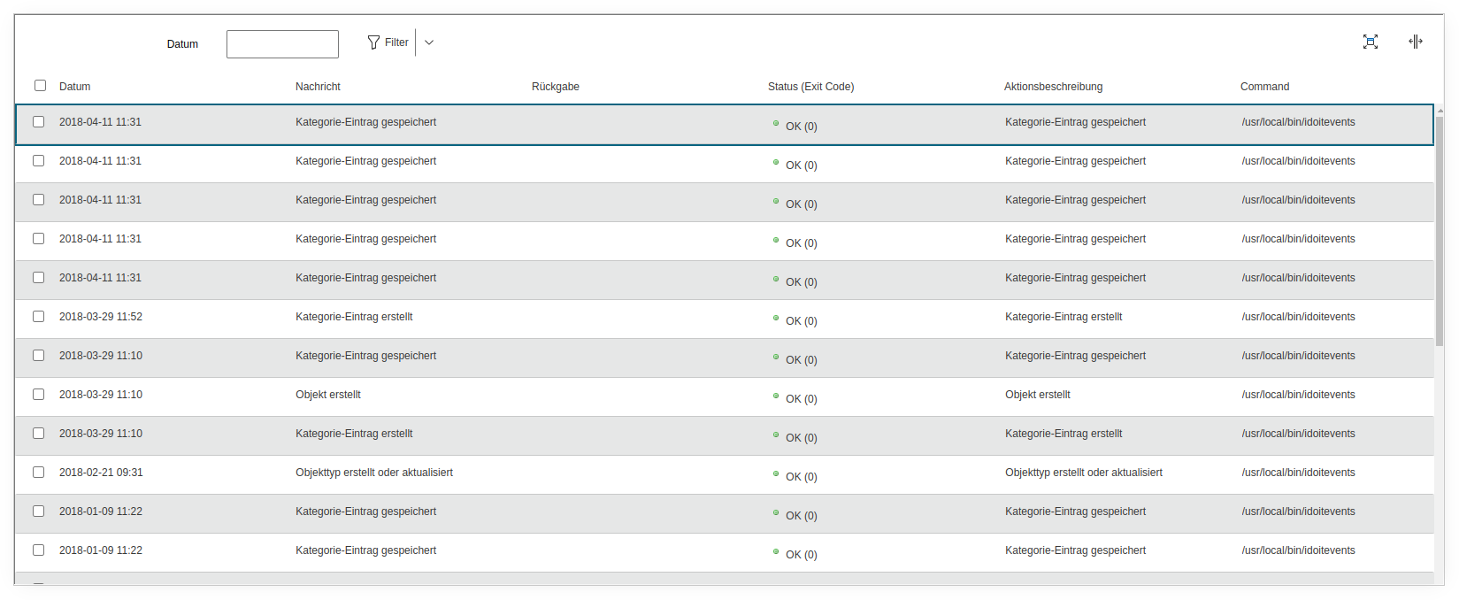

Logging#
Each execution of an event command call is logged. The last 500 entries can be found under Administration → Add-ons → Events → History (Log).
Logging
