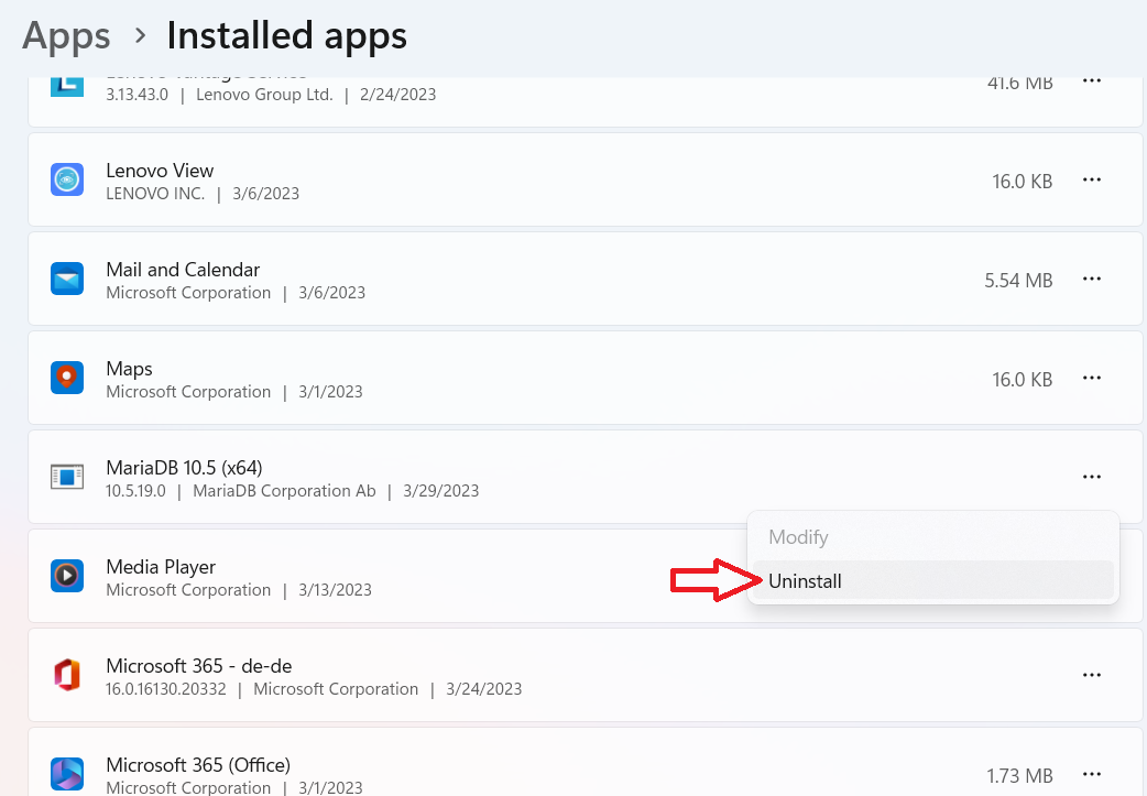

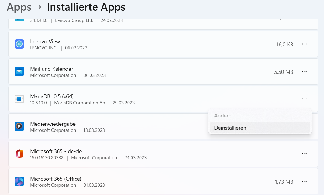

Then uninstall MariaDB by removing it under Add or remove programs.
Uninstall MariaDB

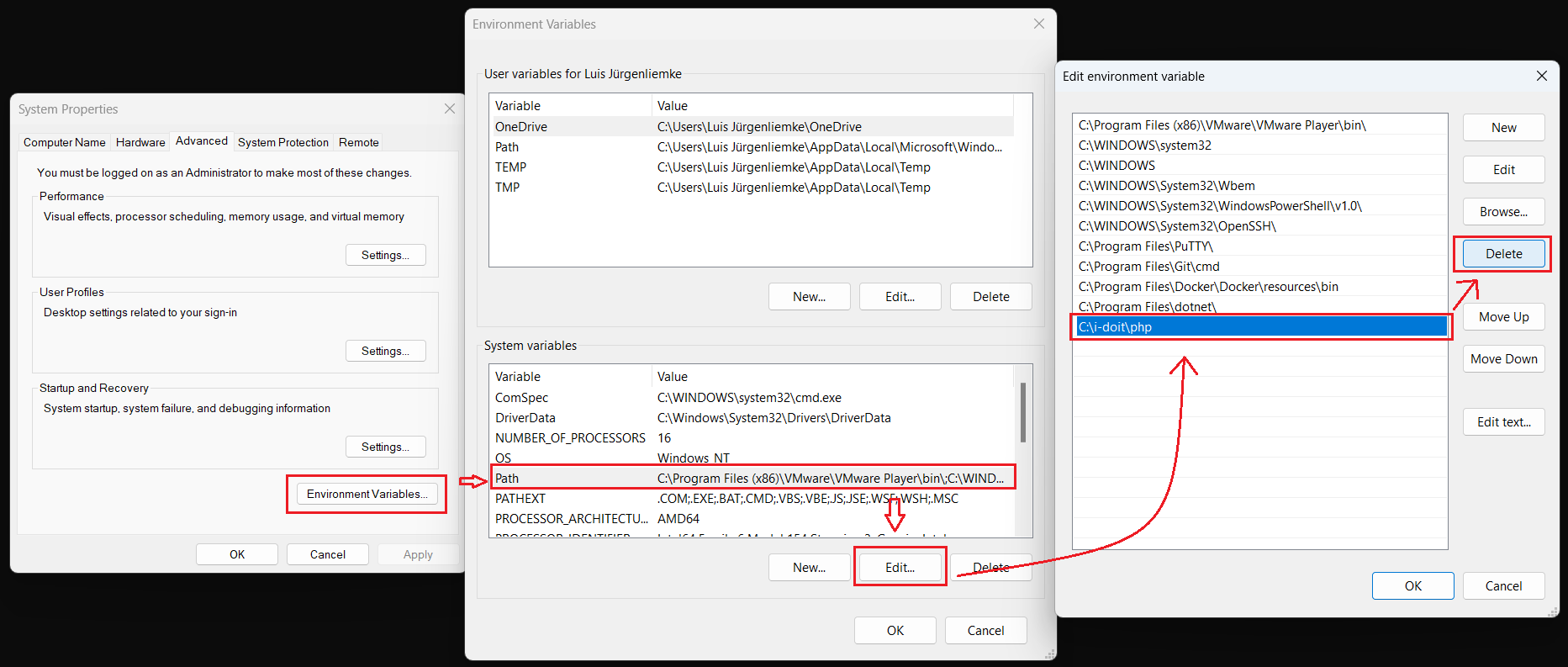

Now the i-doit folder must be deleted and the PHP PATH must be removed from the environment variables:
Uninstall PHP

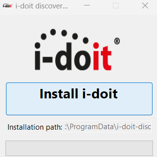

After running the i-doit Discovery Installer.exe, you will see the following GUI:
GUI Discovery
After clicking Install, all required components are installed in the background.

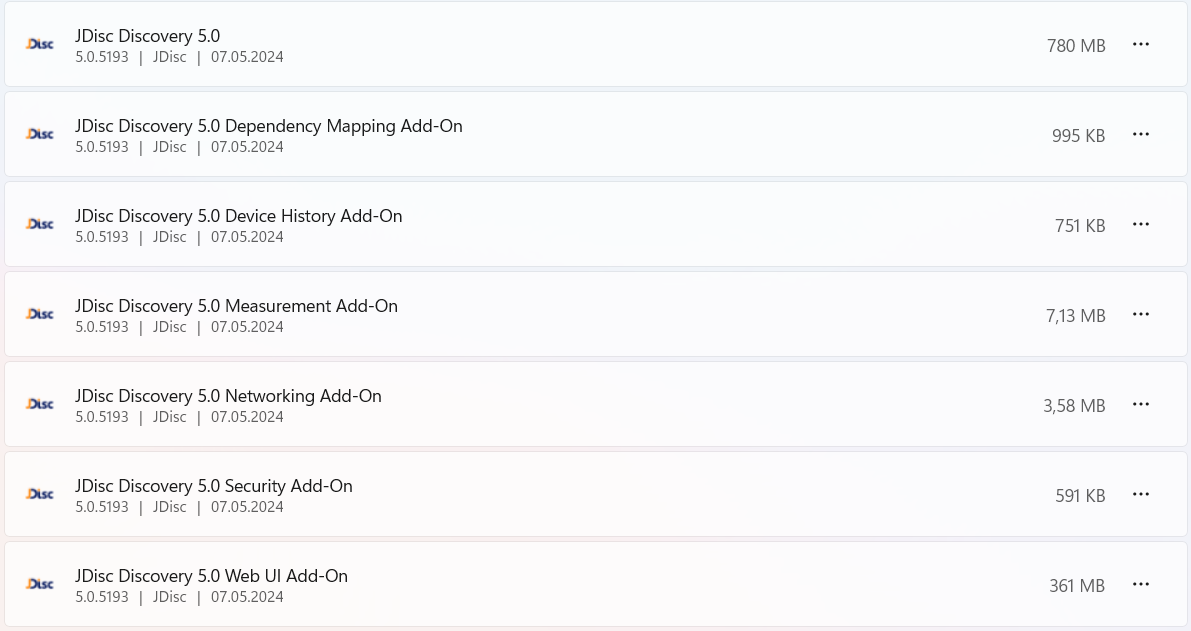

Additionally, JDisc and its add-ons must be removed under Add or remove programs.
The JDisc add-ons must be uninstalled before JDisc!
Uninstall JDisc

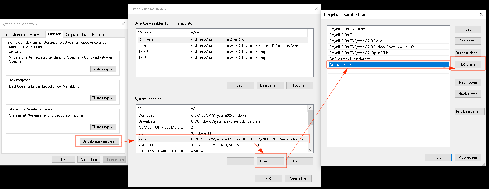

Uninstall PHP
