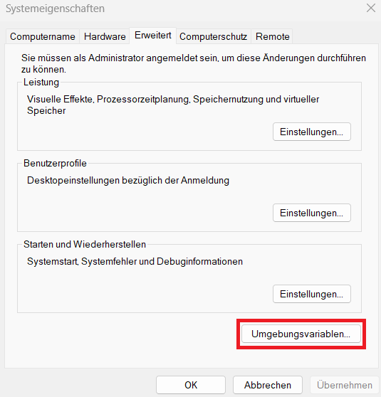

So that we can execute the MySQL commands in the command prompt in the next steps without having to log into the MySQL interface first, we will enter the path to MariaDB in the environment variables.
First, search for "Advanced system settings" via the Windows search and click on the "Environment variables..." button.

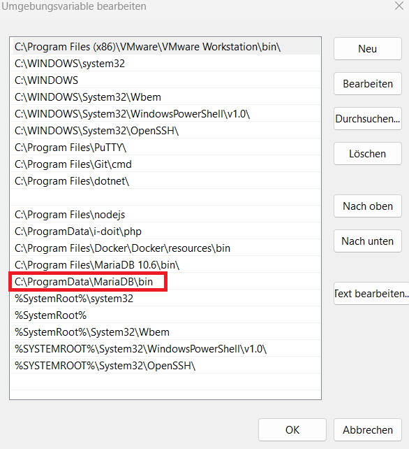

This opens a list of environment variables. Create a new entry and add the path to the bin folder of MariaDB. The i-doit Windows installer should have created this folder under the path C:\ProgramData\MariaDB\bin.
Once the path has been set, you should now be able to use the SQL commands in the command prompt. It may be necessary to restart the window first.
